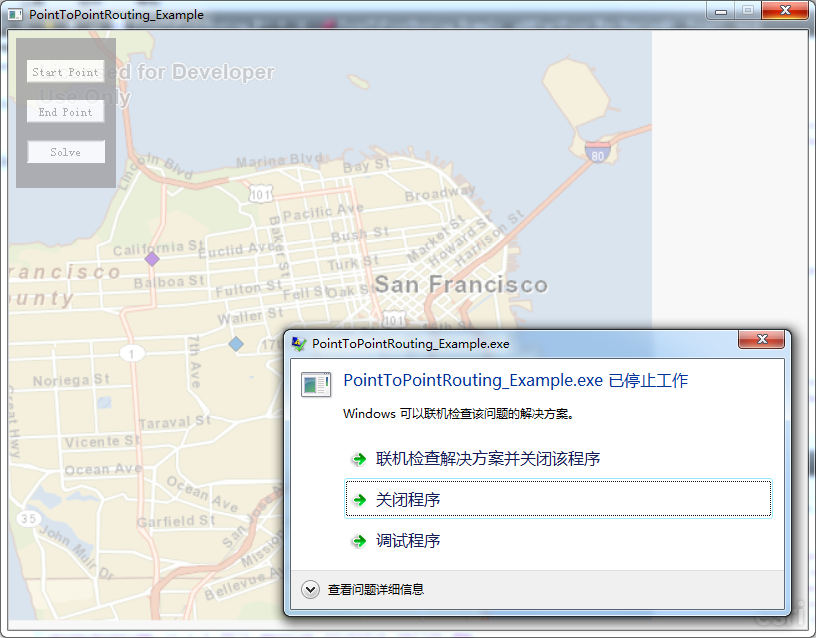

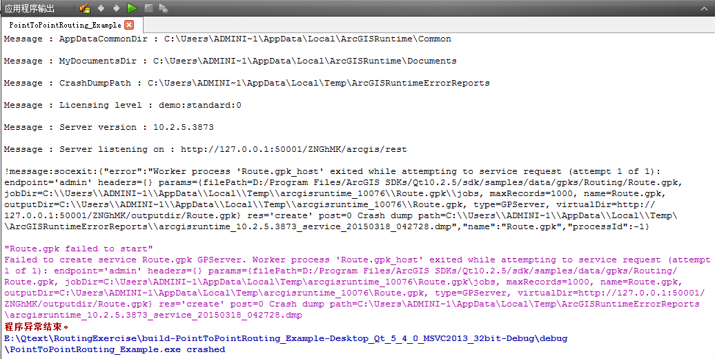

Hi,I followed all the steps of Get driving directions--Create a LocalGeoprocessingService and used the version of Qt(qt-opensource-windows-x86-msvc2013-5.4.0),at last ,when I press the "solve" button ,this .exe fill will be crash,like this:E:\Qtext\RoutingExercise\build-PointToPointRouting_Example-Desktop_Qt_5_4_0_MSVC2013_32bit-Debug\debug\PointToPointRouting_Example.exe crashed. And this  sentence always here--"Route.gpk failed to start" the detail information as follow pictures:QQ截图20150318122808.pngQQ截图20150318122935.pngQQ截图20150318122901.png
LucasDanzinger
Esri Frequent Contributor
Could you please upload the header/source files, so that I can see if there are any differences in the final code that I have and your final code? Thanks!
-Luke
