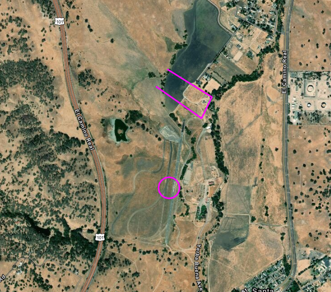

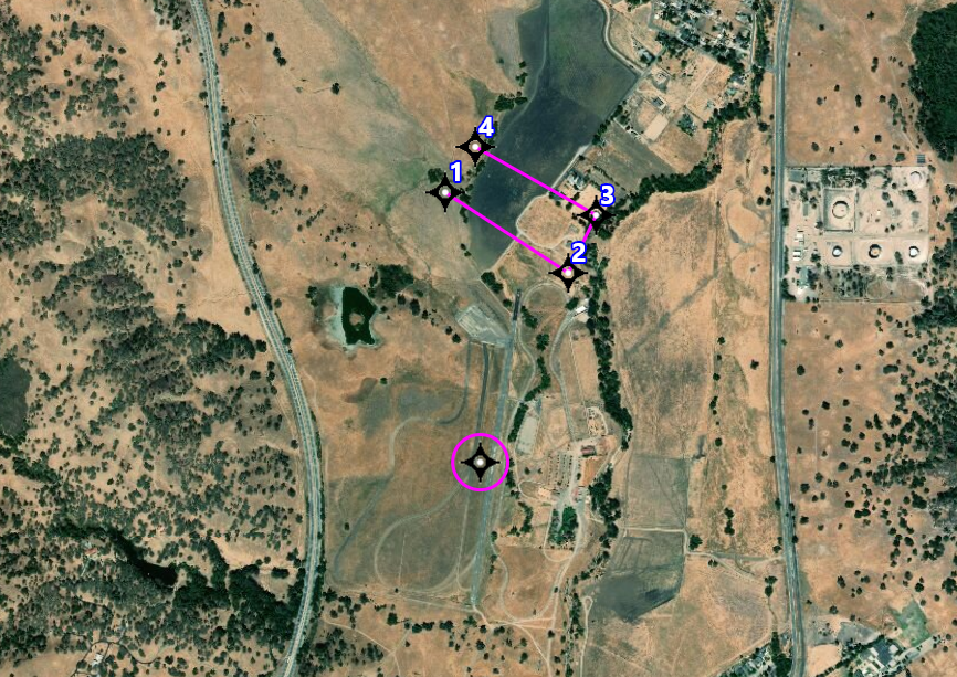

If it is OK, then my follow on questions are related to the inconsistencies that I have seen. The first is that the 2D map is not currently showing the same graphic in the same way that the 3D map is showing it.  I am creating routes for use with flying unmanned air vehicles with waypoints at each vertex that has a symbol and a label.  There can be different symbols depending on the type of waypoint.  On the 3D map, I am seeing all the vertex symbols and labels as expected but on the 2D map I only see the route legs.
3D:
2D:
The next question is kind of similar but in this case, when I set the map to be in 3D at startup and then add a route, the route is not displayed until I toggle to 2D and back to 3D. The route is immediately visible if I'm in 2D mode (albeit missing the vertex graphics) when I add the route.  If I am in 3D map mode, then no route graphics show up at all until I zoom in or out and then toggle to 2D and back to 3D.

I did discover that the waypoint vertex symbols are indeed being added to the map, but way off from where I expect, near lat/lon of 0, 0.
Not sure why those symbol positions are being treated differently in the two GeoViews yet.

Anyway, for the markers showing at null island, have you set spatial reference in the Point c'tor?
BradDuBois
Excellent, that was the issue.  Now I shall (hopefully) never make that mistake again!  Is it interesting that it didn't affect the placement on the 3D map?  I use the same routeOverlay for both the 2D and 3D maps and only 2D had that problem.
