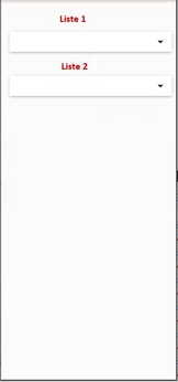

Hello @ALL,
My mobile app contains a UI to let users doing some requests to select data around here position.
I've two combobox listing the possible values to search. The search function works fine and return the desired results.
Here's the app UI

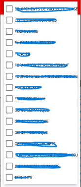

When I display the values of the combobox (both of them), it takes all the height of the app's window. Is there any way to limit the size of the list and allow the possibility to scroll?
Thanks for your help

GISiste
Hello @JamesBallard1
Thnaks for replying.
Actually, I can scroll down in the list if it goes off screen as you said. I've modified the implicitHeight property but It reduces the height of the button itself. Indeed, I would like to limit the height of the popup.
So, I did a workaround, I modified the combobox popup "topMargin" property once the comobox model is set.
myCombobox['popup'].topMargin = 340
I always still can scroll down in the list.
It's what I looked for.
Thanks again for your reply
Regards

JamesBallard1
Hi @GISiste,
A ComboBox in QML should be scrollable by default once it goes off screen. You should be able to limit the height of the combobox by using implicitHeight property.
https://doc.qt.io/qt-6/qml-qtquick-item.html#implicitHeight-prop
GISiste
Regards
GKmieliauskas
Hi,
I use solution from here
On form Completed event I use code below:
    Component.onCompleted: {
        reportTypeCombo.popup.contentItem.implicitHeight = Qt.binding(function () {
                return Math.min(app.isLandscape ? 184 : 276, reportTypeCombo.popup.contentItem.contentHeight);
You can set each of your comboxes individualy.
GISiste
Hey @GKmieliauskas
Thanks for your help.
Actually, I saw that post on stackoverflow but didn't test the suggestion. As, I explained in my previous response I modified my compbobx popup "topMargin" property and did the results I looked for. This moves the popup from top to bottom.
Thanks again for your suggestion
Regards
