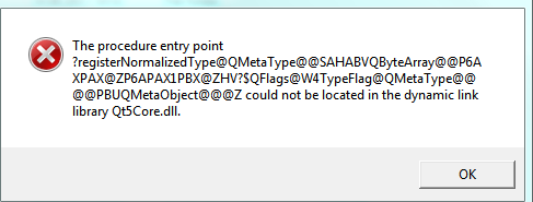

We are tried to get exe with Qt 5.7.1 version with  MSVC 2013 32 bit and when we add app folder as above error is taken as in the "5.7.1_32bit_exe.png" picture  below.
How can we solve problem ?
5.7.1_32bit_exe
Best Regards.
LucasDanzinger
Esri Frequent Contributor
Did you rebuild your executable with this version of Qt?
tanerkoka
Yes, we are rebuilded with  QT  5.7.1  but again gived same error like above "5.7.1_32bit_exe.png" picture.
