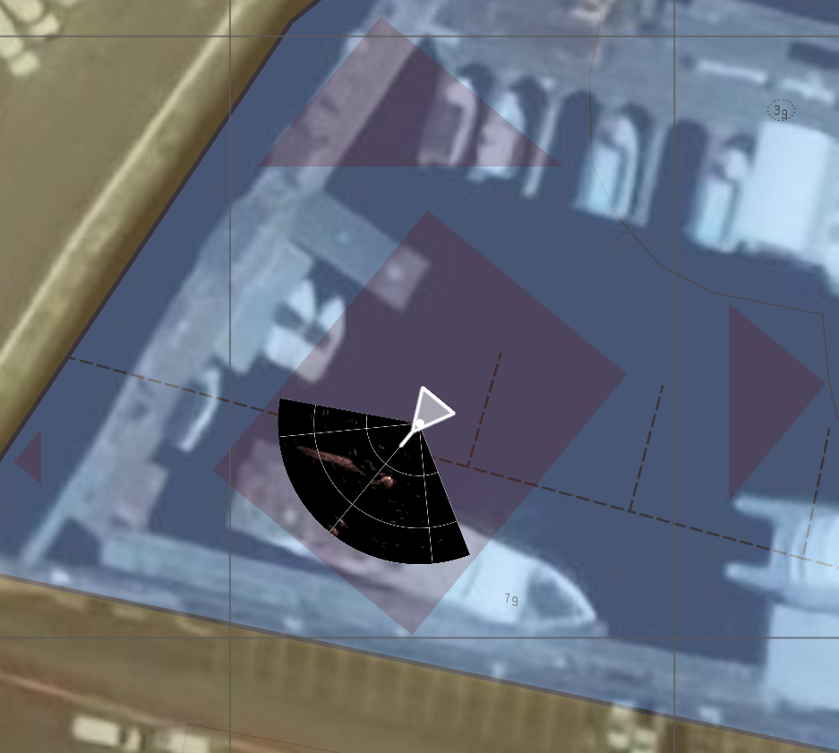

The functionality is great to an extent.  But when the image exceeds a certain size (in this case, 20 meters), the PictureMarkerSymbol seems to unexpectedly change its shape as demonstrated in the 3 images I have attached.  The first image shows a sonar at range of 16 meters, the second a range of 19 meters; you can see the aspect ratio of the image/PictureMarkerSymbol (dim red rectangle with the sonar fan in the front of it) is a distinct rectangle.
When the range reaches 20 meters, the aspect ratio of the image / PictureMarkerSymbol changes into a square!!  I know this is not in the QImage scaling code, as I've stepped through and observed the QImage itself scaling properly.  The "change" happens within the PictureMarkerSymbol.
