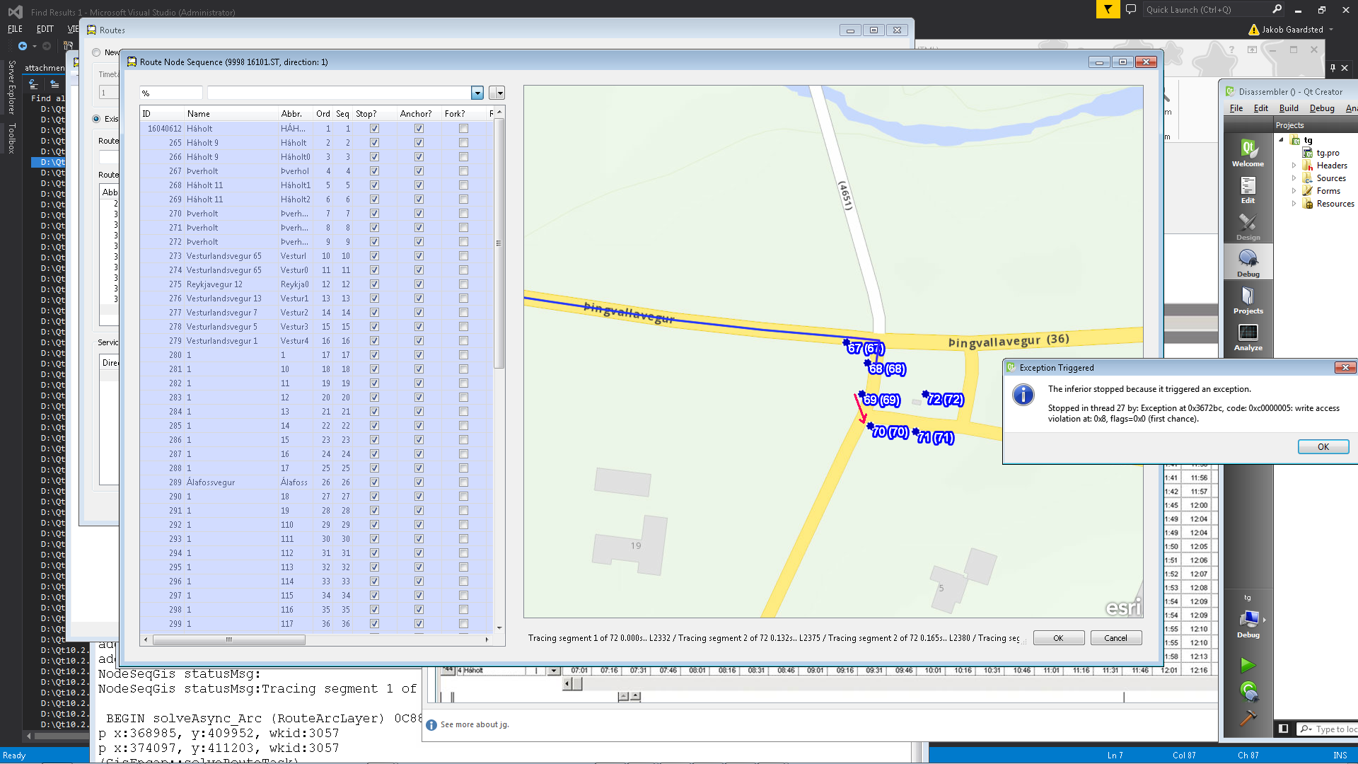

'touching' certain parts of the street network seems to trigger crashes, when calling LocalRouteTask.solve.
I have attached the geodatabase I'm using for routing, to this post.
The data set was built by an ESRI partner, partially with your assistance earlier (msg 595156 - a problem caused by accidental clipping.)
The example trace is between these two points:
  // Iceland, narrow-bad crash:
  ER::Point pointA(-21.590907, 64.180326, EgisProj2::sr_wgs);
  ER::Point pointB(-21.590828, 64.180222, EgisProj2::sr_wgs);
which were precisely chosen to demonstrate the issue. Those points are very close by each other, only because I narrowed them down to 'where the map broke' (the outset was an attempt to trace between points 6 km apart).
Here is a stack trace dump. though I have never been able to get any useful info from any stack traces when ArcGis crashes;
I presume because of the service-styled architecture (ie my call is presumably hidden in some asynchronous hand-off)

My original 6-km  'trigger' points (which caused me to hunt the points listed above), are instead:
  // Iceland, bad crash:
  ER::Point pointAz(-21.6944, 64.1672, EgisProj2::sr_wgs);
  ER::Point pointBz(-21.5904, 64.1803, EgisProj2::sr_wgs);
(I cannot guarantee they cause the identical crash - it may be two similar crashes. But neither of them should crash, if you ask me).
BUT - I _can_ do plenty of other tracing on this LocalRouteTask geodatabase, that _doesn't_ crash. So it's just some parts that act broken.
Given that the crashes bring down our entire application, it's a bit difficult to diagnose, since I need to spend about a minute restarting everything, after each crash.

Hooray - we've found the solution for this! We got some ESRI technical support, who provided us with an 'independent' code sample using our same config, which DIDN'T crash.
The issue was caused by one of the many changes to the API between 10.2.3 and 10.2.6.
We originally wrote the app under v10.2.3.
There, it was legal to have e.g. NAFeaturesAsFeature allocated on the stack.
In 10.2.6, NAFeaturesAsFeature _must_ be heap-allocated with new (applies further, e.g. EsriRuntimeQt::Graphic).
To our bad luck, it didn't cause guaranteed crashes - it "only" failed in rare cases.
To our good luck, it crashed consistently. If it had been a random crash, I don't know if we would ever have solved it :-/.
I can only shudder at the thought of how many further similar 10.2.3-bugs we may have lying in wait for us
- the proper approach would probably be to go through every single numerous line of gis-code we have  for 10.2.6-ishness :-/.
