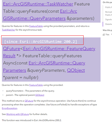

TQGiser
Thank you for the suggestion,but it do not work😂
In the api reference,the offical mathord is QFuture<*>:
and i tried like this:
the resault is:
seems like i have got the Geometry,
but the FeatureQueryResult has not function to get the geometry point list😂
so,what can i do
