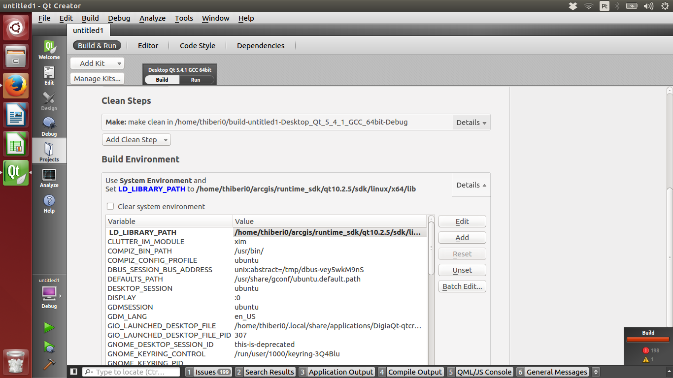

FranciscoThibério
Hi Lucas,
Thanks for answering that quickly. I used the first method that you mentioned, as picture below shows.
However the errors keep happening. Looks like is missing the libc++.so.1 library, however the file is in the same directory of libEsriRuntimeQt.so but I can't add it to project file. Actually I think they are shared library’s. Here is the message when I try to compile:
"warning: libc++.so.1, needed by /home/thiberi0/untitled1/../arcgis/runtime_sdk/qt10.2.5/sdk/linux/x64/lib//libEsriRuntimeQt.so, not found (try using -rpath or -rpath-link)"
I don't know how to use this "-rpath" command, can you help me?

FranciscoThibério
Thank you very much Lucas!
This worked.
