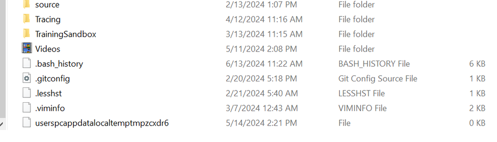

When the SDK is finished installing, it generates a `postInstall.log` file. This is the log output of a script being ran during the SDK installation that handles making the templates available in Qt Creator. If something went wrong, there will be an error message in there. Can you post the contents of this log file?
For me, the file is located at `C:\Users\bnoble0110\AppData\Local\Temp`

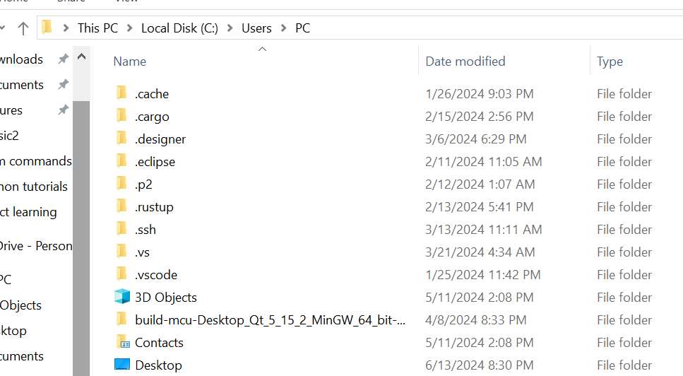

Gem-Vic
I have tried locating the file, but couldn't find it.
I have some screen shorts.

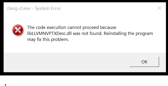

Since I tried to set up ArcGIS on my PC, I started having this pop up whenever I start Qt Creator.
bnoble0110
You may have to re-install Qt Creator, I am not sure why you are missing that DLL suddenly.

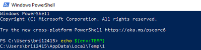

After you do that, re-install the sdk and once its finished, open up a powershell terminal and enter `echo ${env:TEMP}`
This should point you to around where the temp dir is that holds `postInstall.log`. For me, it is up one directory from where this image is pointing.
