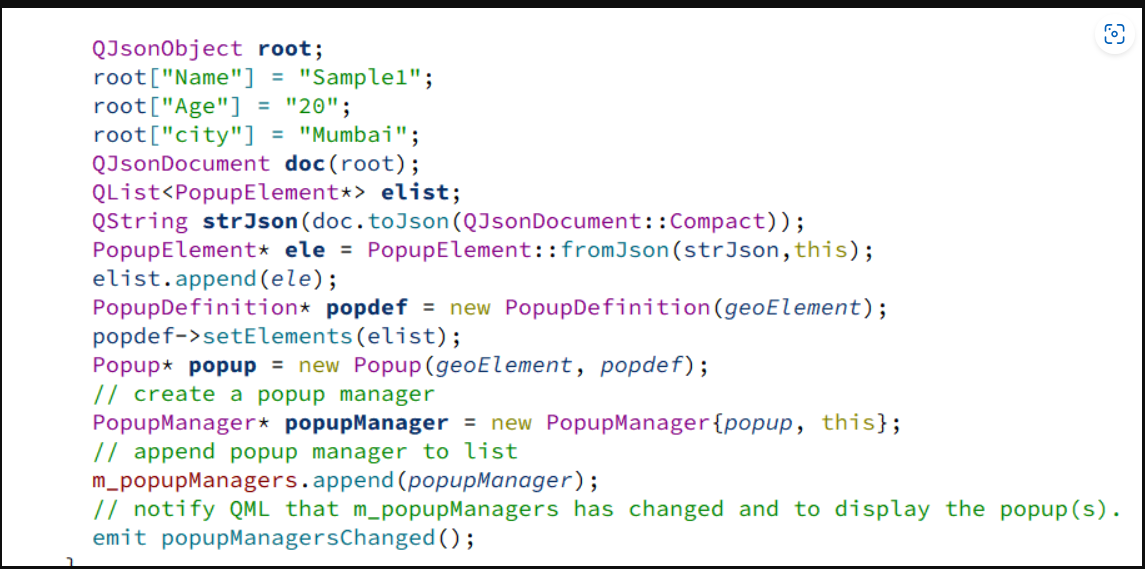

I have the "kml layer" on my map. I want to have a customized popup that will appear on click of placemark on my "kml layer". I want to have customized fields in my popup.
I am using C++ qt SDK and tried to create the popup (as shown in the attached image), but it is not working properly. please help me with this.

Hi Trupti,
Sorry you're having trouble with this. Unfortunately you can't set custom fields to show up in your popup at this time. We're talking about overhauling the Popup toolkit component to make it more customizable, but unfortunately I don't have a timeline for you on when you can expect that to be released. In the meantime, I'd suggest taking a look at our Callout component, because that's much easier to customize and can be given an HTML or Rich Text string to display.
I hope this helps, and don't hesitate to reach out if you need anything else.
