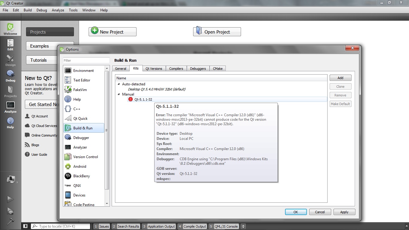

Hi Everyone.  I recently started to use Qt as well as the ArcGIS runtime SDK and I've been having problems trying to get MyFirstMap example to run.  I did everything stated here: Install and set up on Windows—ArcGIS Runtime SDK for Qt | ArcGIS for Developers. I installed
  • ArcGIS Runtime SDK for Qt on Windows.
  • Qt SDK 5.1.1 and Qt Creator 3.3.0
  • I installed WinDbg
  • I installed visual studio express 2013 for desktop
  • I set the prefix in the qt.conf file
  • I integrated the ArcGIS runtime SDK with Qt creator
  • I added the Qt SDK to Qt creator
  • I configured the kit I want to use
The problem is that when I try to select the compiler, I get the following error:
I know the instructions said to use Visual Studio 2012, but it was my understanding that the compiler I needed was the Visual Studio 2012 (C++ 11) compiler and the compiler in Visual Studio 2013 would still work.  Do I need to uninstall visual studio 2013 and use 2012?

Hey Miguel,
With this version on Windows, you will need Qt 5.1.1 with Microsoft VS 2012. It's always possible there is another issue, but for starters, 2012 and not 2013 is what you will need. Let me know how this goes.
Also, just so you know, we will be releasing a new version of the SDK in the upcoming week or so, and this will use Qt 5.4 with Microsoft VS 2013 on Windows. You may want to watch out for this, so that you are using the most up to date version of the software.
