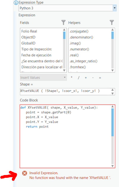

Hi, I was investigating on my own, but I did not get a solution.
I need to move points in a massive way to specific coordinates,
I found a phyton code that makes it perfect in ArcMap,
but the problem is that the points are a feature service,
and in ArcMap it is not so easy to edit, and the service is very heavy for a local copy,
then, I thought I would do it directly in ArcGis Pro, but I get the following error:
some idea of how to do this process in ArcGis Pro?
Thanks!
XanderBakker
Esri Esteemed Contributor
I just tried this and it worked:
The reason might be the fact that you are returning a point object when the geometry is a PointGeometry object.
Code Block:
def Move2NewLoc(pntg, x, y):
    pntg_new = arcpy.PointGeometry(arcpy.Point(x, y), pntg.spatialReference)
    return pntg_new
Code Block:
    return pntg_new
AdminValorInmueble
It works perfect,
thank you so much, you have save my life !
