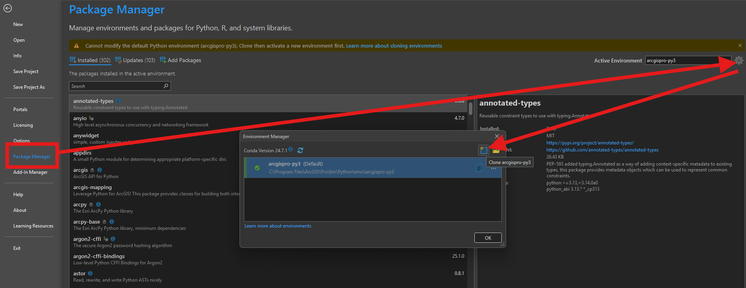

Using this environment will make sure that you aren't writing anything that can't be run by a user that only has the default env installed. If you need to add packages, you can create a new env through Pro:
