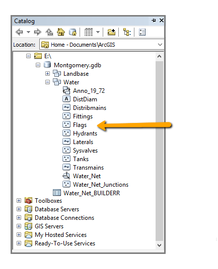

Using ESRI Tutorial Data for Utility Network Tracing (Montgomery.gdb) which is a File Geodatabase and following Arcpy script  I am not getting any erro on running the script to find the path between two points in Flag (point) layer

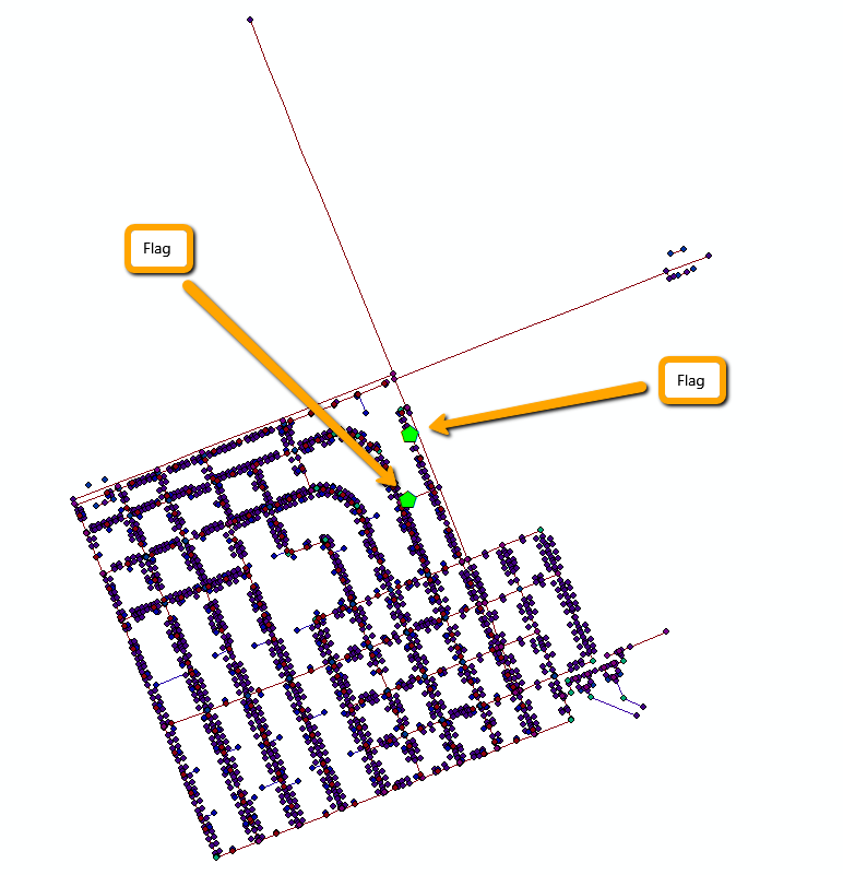

I added the Flag layer manually to the Dataset and it has two points as
again, I am not getting any error but I am not seeing any layer and path to be generated or added to somewhere. Can you please let me know what I am doing wrong or how can I make this rum properly?
