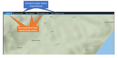

Kaz
I have a similar scenario; I have a python script that automatically creates maps from a template in ArcGIS Pro. There are 3 maps and 2 layouts in the ArcGIS Pro project. I can easily get the layouts to zoom to the new extent of the layers, but (as stated above) there is no functionality to zoom to the layers on the Map View, only the Map Frame within the layout.
My output looks a bit strange because the 2 layouts are centered on the data but the 3 maps are set to the template's extent (which doesn't show any data). The user could always open the project, right click on a layer from the content pane, and choose "zoom to layer" but that feels a bit redundant.
Could you explain the work around you mentioned above? Or maybe there is a better work around for my use case?
