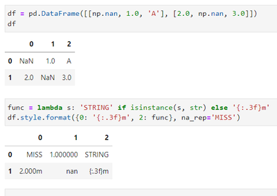

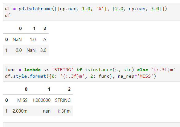

I'm trying to pass conditional string formatting from a function back to style.format as shown here....
Ultimately, I'm looking for the same results as above EXCEPT {:.3f}m should be 3.000m in the output displayed dataframe.  Any ideas?

Here's the code for testing:
df = pd.DataFrame([[np.nan, 1.0, 'A'], [2.0, np.nan, 3.0]])
df
func = lambda s: 'STRING' if isinstance(s, str) else '{:.3f}m'
df.style.format({0: '{:.3f}m', 2: func}, na_rep='MISS')
dslamb2022
I think you are missing the format function.
'{:.3f}m'.format(s)

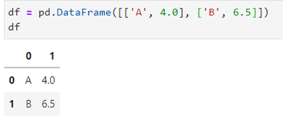

In the same vein, do you have any notion of how to set conditional formatting based on another column?  Let's say we have...
and we want to produce this...
where: if value in col 0 == 'A' then format float as '{:.3f}f' and if col 0 == 'B' then format as '{:.3f}m', using df.style.format() or other formatting/styler methods.
