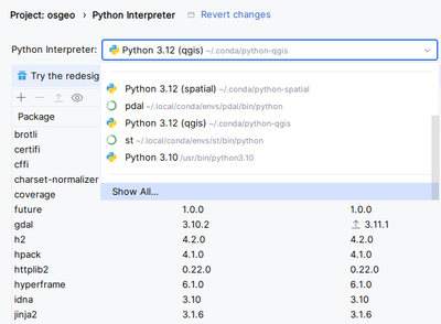

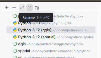

The interpreter was added to PyCharm when you had an older ArcGIS Pro/python installed. When you added it, PyCharm chose a default "name", which was the python version in your case and the name didn't get changed when the python version was updated. The "name" is just a PyCharm alias and that it refers to the wrong version doesn't actually matter (apart from being a bit confusing).
You can rename the interpreter by going to File -> Setting -> Project -> Python Interpreter (or clicking the Interpreter item in the bottom right Pycharm bar)
Select the Show all in the interpreter pick list:
Select the incorrectly named interpreter and click the "Rename" button and change the name to whatever you want, perhaps arcgispro-py3 or similar:
