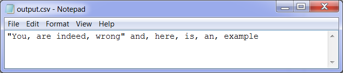

We will try this again for posterity...
>>> # for those that may encounter this problem in the future
>>> my_response = '"You, are indeed, wrong" and, here, is, an, example'
>>> f = open('c:/temp/output.csv','w')
>>> f.write(my_response)
>>> f.close()
output in text file
Images... in Quattro Pro (a spreadsheet) and in notepad... But try it yourself with the code above
Be careful the my_response line consists of a single quote, ', followed by a double quote, ", another double quote to encapsulate the first expression and finally another quote to complete the whole thing.
This is standard Python stuff when trying to quote quotes...you have to mix them up ... two double or single quotes side-by-each simply encase space...the void...
All done without the csv module, if you know what the csv module does...it makes it easier.
