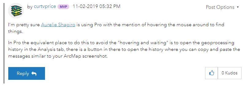

How do you script out the location of the txt file / is there more to the script than what has been shared on this thread.
I am wanting to extract the Message from geocoding results and log them in a txt file with the corresponding txt file that is created when you "Save A Python Script", since doing that does not bring along the messages.
In this thread it is said to manually copy and paste the messages to a txt file directly from the GP History log pane in Pro
https://community.esri.com/t5/modelbuilder-questions/model-builder-can-i-write-text-from-results-win...
It would be nice to be able to run weekly geocoder rebuilds and geocode our address data against our actual and theoretical address ranges along with a fishbone analysis to track and log the progress and accuracy of our address data, especially since this data is shared with our communications people.
