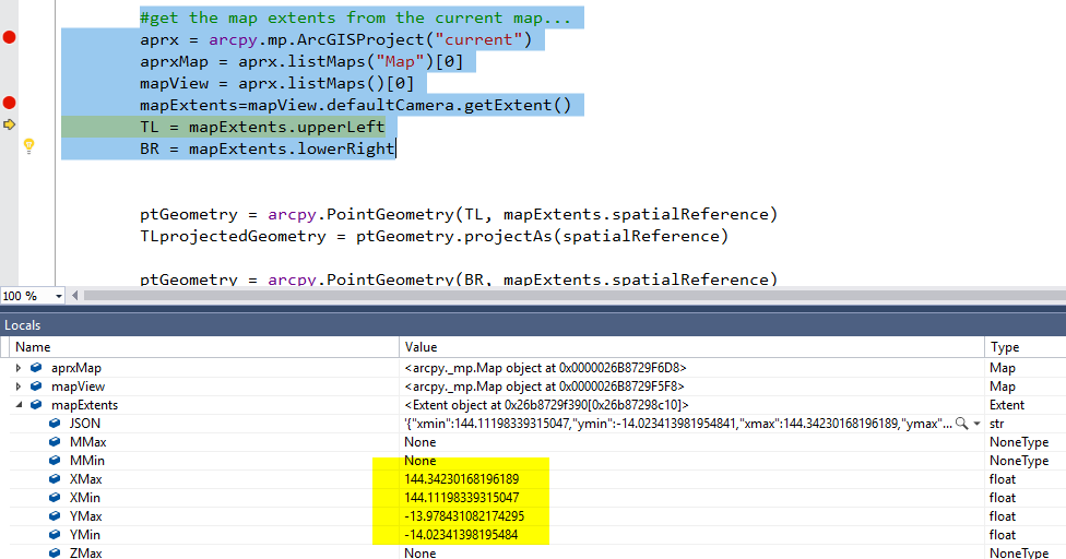

I am using arcgispro 2.2.4, and have a python script which needs the actual extents of the current map view.  I use this code...
#get the map extents from the current map...
 aprx = arcpy.mp.ArcGISProject("current")
 aprxMap = aprx.listMaps("Map")[0]
 mapView = aprx.listMaps()[0]
 mapExtents=mapView.defaultCamera.getExtent()
 TL = mapExtents.upperLeft
 BR = mapExtents.lowerRight

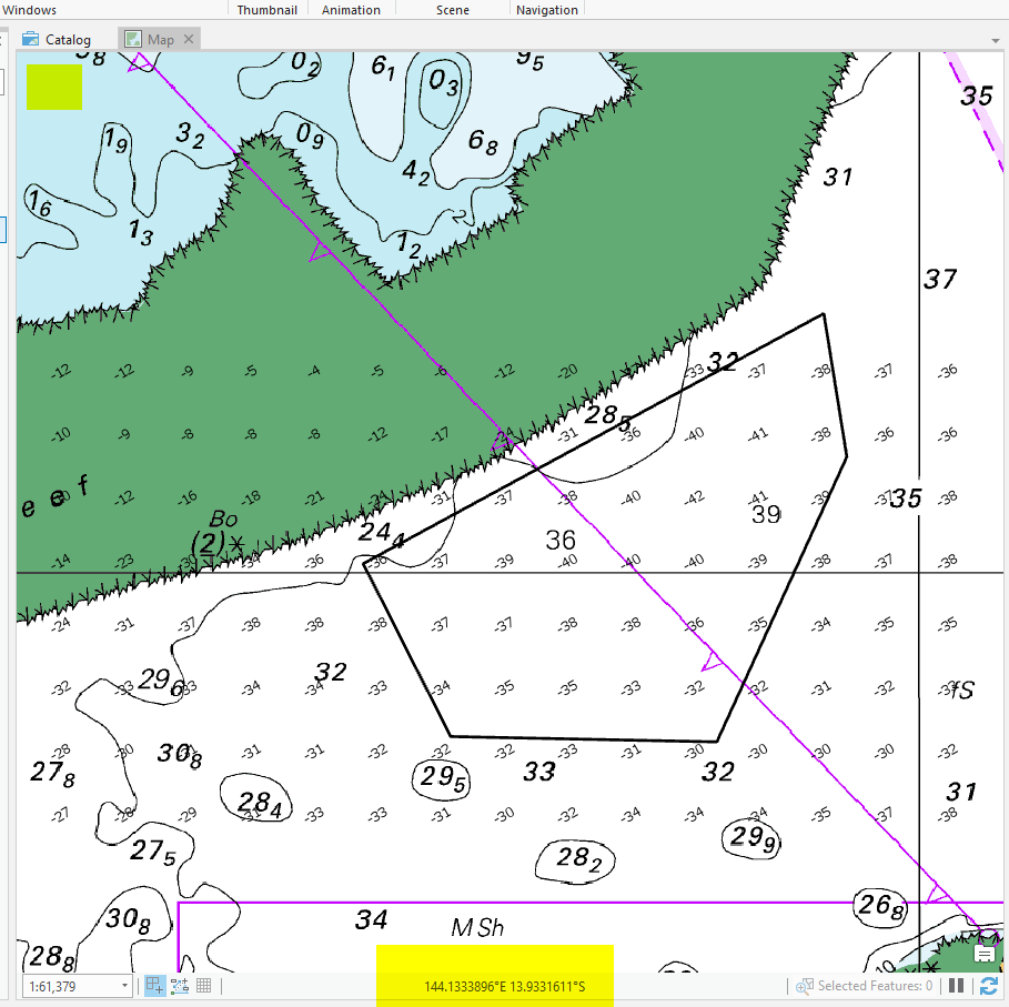

which suggests the map upper latitude limit is -13.978...
however, if I roll my mouse to the top left of the map view, it is more like -13.933
The extents do change when I pan the map, but they are always a significant subset of the actual viewable area, which is really strange.

Having debugged this further, the camera extents DO-NOT change when the map is panned/zoomed and the python script rerun. The numbers remain the same.
I guess I am doing something wrong, just not sure what!
