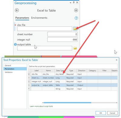

Well, in my excel to table, I used Any Value, so give it a shot if you don't want to navigate to a sheet

Try workspace, then you have to read the sheet name

Well, if I navigate to the xlsx file using Any Value it still wants to open up to the table. But if I use the path to the table I just delete the table from the path and the script runs. That may be the best I get.
