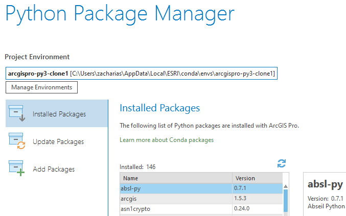

Apparantly, ArcGIS Pro saves user created conda envs in C:\Users\userxyz\AppData\Local\ESRI\conda\envs\.
The ArcGIS Pro Python Package manager confirms this:
But when I start the command console by executing "C:\Program Files\ArcGIS\Pro\bin\Python\Scripts\proenv.bat",
I don't see these envs when I do "conda info --envs".

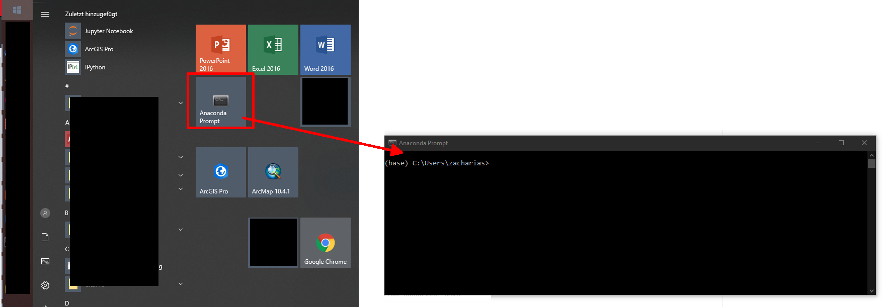

I want to manage my Envs via command prompt. What can I do? Usually, Anaconda installs a shortcut to the "Anaconda Prompt", which executes "%windir%\System32\cmd.exe "/K" C:\anaconda\Scripts\activate.bat C:\anaconda".
Where is the equivalent Anaconda Prompt for ArcGis Pro's Miniconda install?
