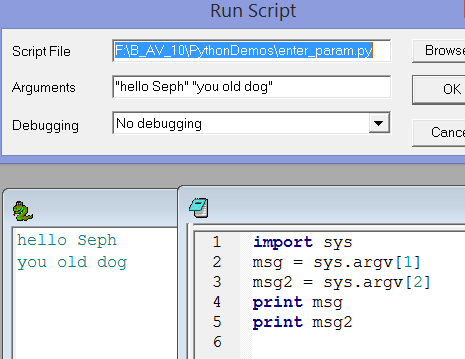

DanPatterson_Retired
MVP Emeritus
ahhhh  Just a pythonwin example  every IDE is slightly different
SepheFox
Deactivated User
Oh neat! Thanks for the info. So, for more than one argument, would you just put a list with commas between?
MVP Emeritus
details with your IDE space delimited for PythonWin

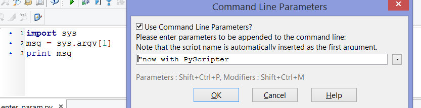

MVP Emeritus
Here is PyScripter example
