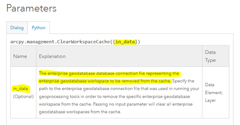

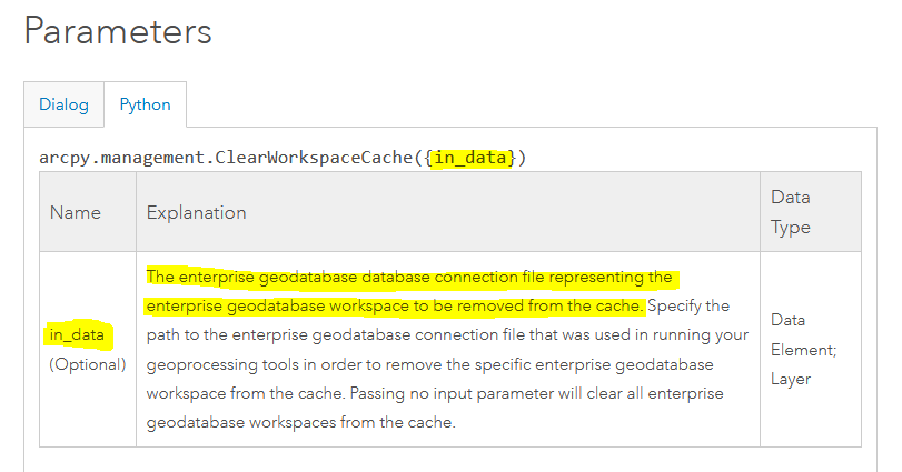

I see that the Clear Workspace Cache documentation shows the above example in the official code sample, but that documentation also shows that the input data can still be included within the tool itself.

DanPatterson
MVP Esteemed Contributor
The error is non-descript
000585: Warning occurred during execution.—ArcGIS Pro | Documentation
and you may have found the solution
