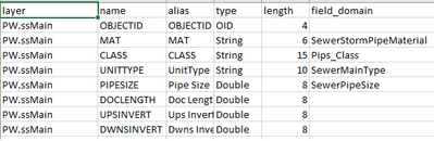

This is the output:

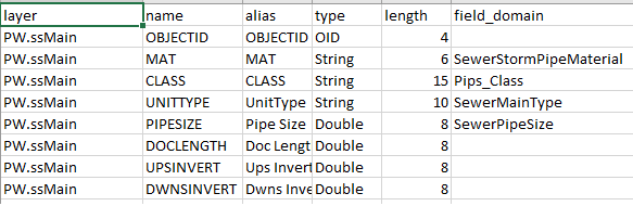

Where I want to be:
The final step, my dear colleagues, would be to list the codes and code descriptions for the domains output by this script.  I'm not sure whether it could all be output in a specific column in the same csv, or as a separate tab on the csv for reference.
This is loosely what I want:
I am stumped.  Any creative solutions?  Thanks in advance!
