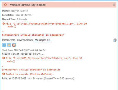

matu89
hey, i cannot run that script it wont run .
here is the error:
any help would be appriciate!
thanks!
JordanKeller
I'm getting the same error with this code. It worked for me in ArcMap but not when I run it in Pro.
Could it be differences between Python 2 and 3? I'm not familiar enough with syntax differences between the two that might be tripping me up in Pro. Any ideas?
