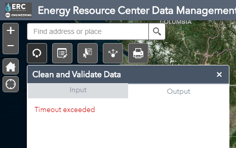

I've published a geoprocessing service and recently noticed that it times out at 3 minutes.  I tried updating maxUsageTime but it had no effect. I inspected the service draft xml document and found no timers set to 180 seconds.  How can I prevent this from timing out after 3 minutes?

I actually tried that and it didn't work because the service is being called from the ESRI-supplied geoprocessing widget which apparently does not support asynchronous processing. In any case I would prefer synchronous. What I don't understand is why it is timing out after 3 minutes when I have set the timeout to 10 minutes.
DonMorrison1
I'm beginning to think that the timeout is happening on the client (WAB Geoprocessing widget) instead of the the server's geoprocessing REST service.  When I run the service directly via an HTTP POST sent to the REST service it does not timeout. It only times out when I run it via the WAB widget.  I can't see in the widget code where the timeout value is being set - in any case I'm quite sure I can't do any sort of customization since my web app is being served up in ArcGIS Online.  Also, from looking at the Geoprocessing widget code it looks like it should support asynchronous gp services - but I always get a failure pretty much immediately when I try that..... has anybody been able to get that to work?
