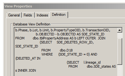

I am having an issue with the TableViews. When using the walk function, with a datatype of "Table", I can print the File Name, but not the WhereClause. (I can see the definition in the View Properties dialog box.)

Short answer is you can't, unfortunately.  The table view | Definition - Esri Support GIS Dictionary   isn't what you think it is, at least in terms of the Describe classes:
A representation of tabular data for viewing and editing purposes. The table view created when a table is added to ArcMap is a copy of the actual table data stored in memory.
The TableView is an ArcGIS object, not a database object.  Exploring the Describe—Help | ArcGIS Desktop property groups, one sees there is no group of properties for either "Database View" or just "View," which is what we would need to extract the SQL behind a database view.
Now you might be thinking, why does Walk—Help | ArcGIS Desktop return the database views when I pass datatype of "Table"?  I can't answer that question, maybe someone from Esri can weigh in on that one.
