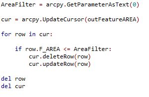

Hi, I'm trying to use the GetParameterAsText() for user input.
When I use a value instead, it works fine but not with GetParameterAsText()
Any help will be greatly appreciate.
               NOT WORKING                                                                 WORKING
AreaFilter = arcpy.GetParameterAsText(0)
cur = arcpy.UpdateCursor(outFeatureAREA)
for row in cur:
    if row.F_AREA <= AreaFilter:
        cur.deleteRow(row)
        cur.updateRow(row)
del row
del cur
