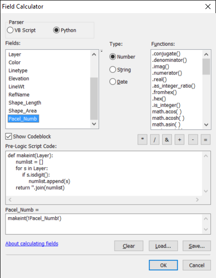

I feel kind of dumb but I cannot figure out how to make this work.
This should be easy, I think, but field calculator is making it difficult for me. I have one field that has text and numbers. I want to use Field Calculator with Python to just grab those numbers and put them into my Long Integer field.
I tried using the example from Stack Exchange but maybe I am doing it wrong because this example is making it a string?
(this returns nothing in my records)
What am I doing wrong?

AdrianWelsh
MVP Honored Contributor
James, that makes sense and I ran the codeblock in Field Calculator with your code, but it didn't return anything. There were no errors though. Is there something I am doing wrong?
The field that I am grabbing the values from is called "Layer" and I am putting the values into "Parcel_Numb".
def makestr(Layer):
     numlist = []
     for s in Layer:
         if s.isdigit():
             numlist.append(s)
     retlist = ''.join(numlist)
     if any(char.isdigit() for char in retlist):
         return retlist
and for the bottom part:
makestr(!Pacel_Numb!)
Is it a syntax issue?
AdrianWelsh
Ok, it was the bottom part.... I needed to make it say:
makestr(!Layer!)
...sheesh...
Thanks James! Again, you're the best!
