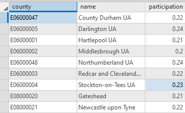

data table (county links to link table fields)

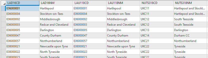

Link table links LAD16CD to county of the data table and NUTS318CD of the feature layer

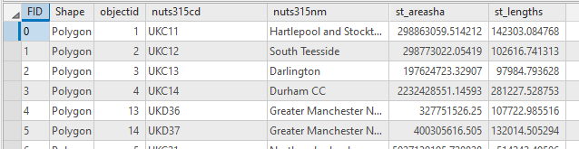

Feature layer attribute table
I need to link the tables together then extract the values for each county of interest and calculate the mean participation value from the data table and then link the mean to the feature layer.
in essence I need to have the attribute table of the feature layer have a field that contains the mean participation data for each NUTS3 code
i have no idea what approach to take and could do with some advice.

There appears to be a potential issue with the relationships between the fields you mentioned in the three tables. One NUTS318CD value can have many LAD16CD (county) values. Because of this, you'll be putting multiple different participation values together for each NUTS3 code. Do you intend to sum or average the participation values? Alternatively, you would need to create multiple NUTS3 code features, each with a different participation value.
DanielFuller
Yes thats correct, effectively they are two levels of governance, so there are multiple LAD16CD values for each NUTS318CD value. I need to workout the average participation value for each NUTS3 code, as that is the level for my feature layer.
I think i need to extract unique values of the NUTS318CD field but i'm stuck on how i would go about calculating the average for each field if you understand my meaning
