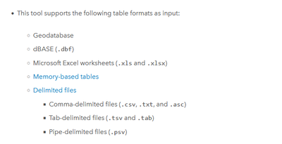

Hi Lindsay,
I didn't think that you could use a feature service as an input to the Export Table geoprocessing tool? In the documentation https://pro.arcgis.com/en/pro-app/latest/tool-reference/conversion/export-table.htm it doesn't indicate that you can do that
I have managed to do something similar by having the web service in a map in an arcgis pro project before, and accessing the layer via ArcPy.
