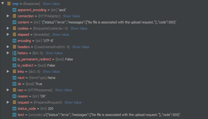

If I look at the resp object in the debugger I see:
content = {"status":"error","messages":["No file is associated with the upload request."],"code":500}
