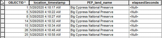

Need to calculate elapsedSeconds column by first sorting on location_timestamp and then evaluate if PEP_land_name matches in row[n] and row[n+1]. If true, then set row[n+1] to elapsedSeconds value.

I seem to be close in that I can arrive at the correct sort and evaluation, but I'm not exactly sure what to do about the updateCursor and setting the elapsedSeconds value in row[n+1].  In the attached image, OID 1 elapsedSeconds would be 0, OID 5 would be 5, and so on and on...

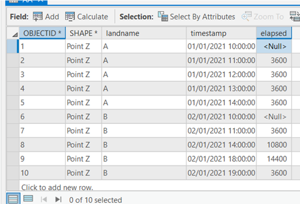

Unless I've misinterpreted what you're trying to achieve, I think it can be done without and .next() or nested cursors.
I've just created global variables to hold the previous land and timestamp values for each row:
import arcpy
fc = r'PathtoMyFC'
previous_timestamp = ''
previous_land = ''
with arcpy.da.UpdateCursor(fc, ['landname', 'timestamp', 'elapsed']) as cursor:
    for row in cursor:
        this_timestamp = row[1]
        current_land = row[0]
        if previous_timestamp is not None and current_land == previous_land:
            time_diff = this_timestamp - previous_timestamp
            total_seconds = time_diff.total_seconds()
            row[2] = total_seconds
        previous_timestamp = this_timestamp
        previous_land = current_land
        cursor.updateRow(row)

if the rows oid=1 and oid=5 (see image in op) are the 2 rows being evaluated and elapsedSeconds calculated, does your suggestion update row OID=5?
In the image OID=1 should be 0.00 seconds and OID=5 should be 5.00 seconds

DavidPike
MVP Notable Contributor
import arcpy
fc = r'PathtoMyFC'
previous_land = ''
    for row in cursor:
