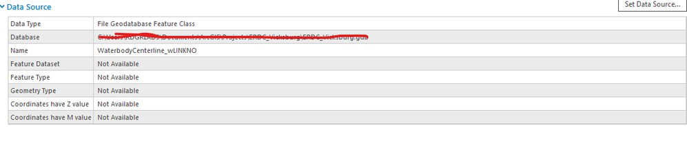

I am trying to update the connection properties of a group layer onto a new geodatabase, and even though the script runs, the data sources end up being broken. I was wondering what I can do to fix this?

This is what the data source is supposed to look like for the layer:
However, even though it successfully updates connective properties to the certain geodatabase I want, this is what the data source looks like for the layer when I run the code:

I've been wrestling with that method call all week.  I think passing a dictionary in to it is getting me closer. I will try to post some actual code here later. Basically I read the existing properties, modify, then write back out.
I iterate over all the maps in an APRX, then iterate over the layers in each map.  Then read properties for each layer, modify, write to map, then save the APRX.
It's not perfect yet but it's getting better.
