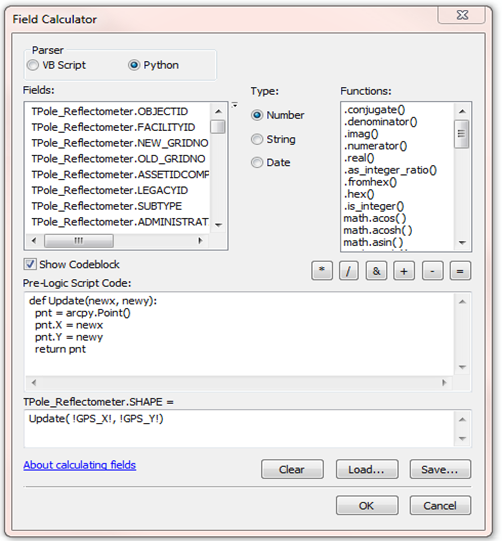

Thanks Blake for the response! But I was wondering how I could write that in a Field Calculator. Currently I'm using this script:
I was wondering how I could write to leave all blank values alone and only calculate points that have a value. Thanks again for any help!

Ah, I see. In this case, it would be easiest to simply select by attributes where GPS_X is not null and GPS_Y is not null then perform the field calc you have and it will only affect the selected records.
