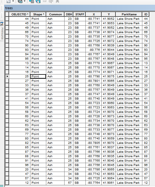

This is a screenshot of my attribute table.

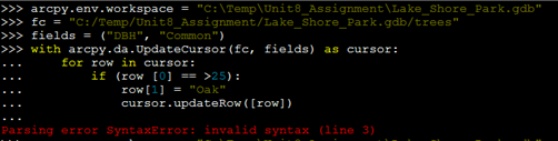

This one of countless attempts:

Your first line fails in my IDE using python 3.5
a = "C:\Temp\Unit_8_Assignment\Lake_Short_Park.gdb"
  File "<ipython-input-7-23a9732c065c>", line 1
SyntaxError: (unicode error) 'unicodeescape' codec can't decode bytes in position 7-8: truncated \UXXXXXXXX escape
a = r"C:\Temp\Unit_8_Assignment\Lake_Short_Park.gdb"  # ---- using raw formating
'C:\\Temp\\Unit_8_Assignment\\Lake_Short_Park.gdb'
I didn't get beyond there since I don't have the data to test.
It looks offhand that your row[0] and cursor.update.... row have 5 spaces and not 4... check

Try this:
fc = r'C:\Temp\Unit8_Assignment\Lake_Shore_Park.gdb\trees'
fields = ("DBH", "Common")
with arcpy.da.UpdateCursor(fc, fields) as cursor:
    for row in cursor:
        if row[0] > 25 and row[1] == "Ash":
            row[1] = "Oak"
            cursor.updateRow(row)
Your line:
if (row [0] == >25):
is not valid for 2 reasons, and perhaps 3 reasons:
  • the additional space after row
  • the == > which should actually be just >
  • if another species (no Ash) would be larger than 25 it would be changed to Oak and that might not be correct

Thank you so much! Darn Spacing! I was thinking too that if another species was larger than 25 it would mess it up I just didn't know what to do.  I didn't know I could use the 'and' . This class is online and very difficult to ask for help when I'm working on it. I thank you for taking the time to show and explain it to me. Have a great night.
