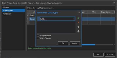

So when you set up the script tool, you can set values to have multiple values rather than creating individual parameters for each point. In which case the end user can add as many points as needed.
