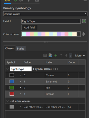

danieloccasionally
The TWP + "_RIGHTS" layer use domains, I'm thinking now that's the source of the problem
danieloccasionally
Huh. It appears that the actual information is stuck in "all other values".
