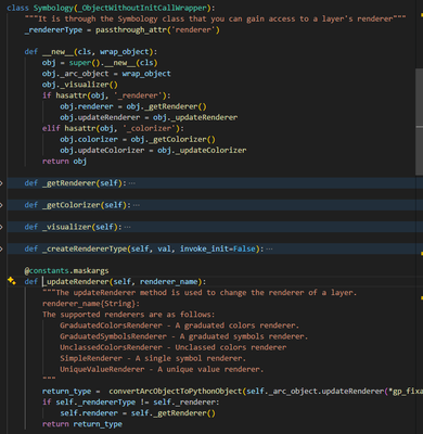

There's also the odd thing with the updateRenderer function call for a Symbology object having a pseudo private/internal function header:
Which is odd as I think that's a function that a user should call, and not one that is only used internally by a Symbology object. It's also wrapped by maskargs which is a nearly inscrutable decorator function that apparently does some magic with the function argument names?
