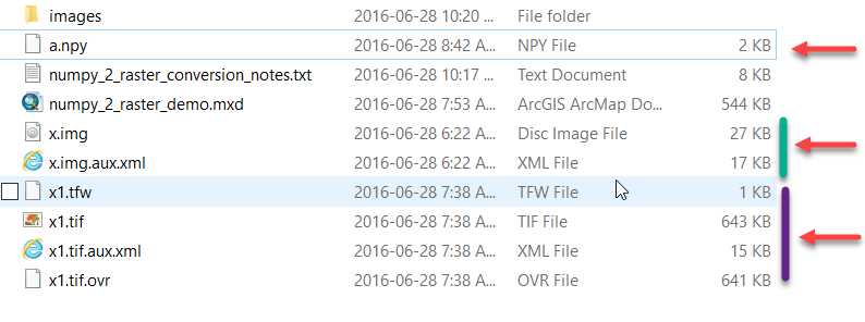

I can't narrow it down further... I normally use *.npy files to store multiband rasters/arrays, they are way smaller and I rarely need to map something.
These three are the same array in npy, img and tif formats
