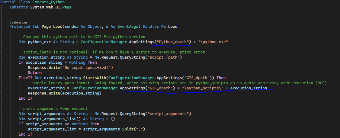

In my .NET code I have also mentioned the valid python path as shown below
Is there any suggestion you all think of? Thank you in advance.
