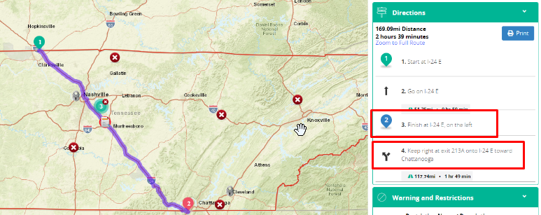

We are using ArcPy.NAX for route-solving solutions and to get the turn-by-turn directions. Recently we have observed that it's solving routes as expected and also returning turn-by-turn directions, but the sequence of turn-by-turn directions is not correct. Attaching a couple of screenshots for reference. This is a random behavior. Sometimes it returns correctly and sometimes it gives incorrect results.

Screenshot of directions:

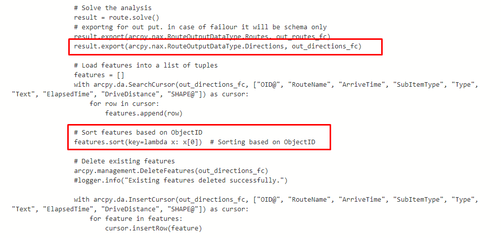

We also tried to sort the directions feature class based on the object id but still it's giving the same result. Snapshot of python code.

Please find the requested layer file as an attachment. For this route, it's happening every time and another observation is that if we remove the barrier then it's working fine.
We are not doing anything with the directions. We are only setting directions in the output parameters after generating it. Here is the screenshot from the tool.
Another observation is that this is happening when we are loading the line restrictions but if we don’t load it then it’s giving directions as expected. Below is the code which we have used to load the line restrictions.
