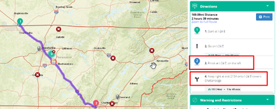

We are using ArcPy.NAX for route-solving solutions and to get the turn-by-turn directions. Recently we have observed that it's solving routes as expected and also returning turn-by-turn directions, but the sequence of turn-by-turn directions is not correct. Attaching a couple of screenshots for reference. This is a random behavior.  Sometimes it returns correctly and sometimes it gives incorrect results.

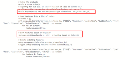

We also tried to sort the directions feature class based on the object id but still it's giving the same result. Snapshot of python code.

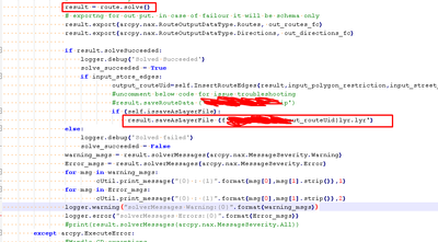

Hi Alok, I understand your observation of this behavior is it's random. Do you think you could create hardcoded script that i could point to my local version of SMP that can reproduce this if i run it a few times? by hardcoded, i mean you set all the parameters needed to create the route.
Alternatively, you could export one of these solves to a layer package via the result object
https://pro.arcgis.com/en/pro-app/latest/arcpy/network-analyst/routeresult.htm

Please find the requested layer file as an attachment. For this route, it's happening every time and another observation is that if we remove the barrier then it's working fine.
We are not doing anything with the directions. We are only setting directions in the output parameters after generating it. Here is the screenshot from the tool.
