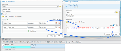

@MikhaylaB Can you share an example of the string objects held by the date_before and date_after variables? (I see you specified mm/dd/yyyy which is what I used in the test below, but just want to confirm what exactly is held in the variable. Also, I'm not sure how the app is setup but depending on the contents of request.form you may need to handle Null values when building the SQL Query.)
Here is a quick test to show how the Select By Attributes window handles an input string in the format MM/DD/YYYY (top left window). ArcGIS Pro converts it into YYYY-MM-DD HH:MM:SS SQL string if the field is a Date type (top blue arrow) or into YYYY-MM-DD SQL string if the field is a Date Only type (bottom blue arrow). You will need to mimic this conversion based on the structure of the strings in your date_x variables and the field type of the attribute table you are trying to query with your where_clause.

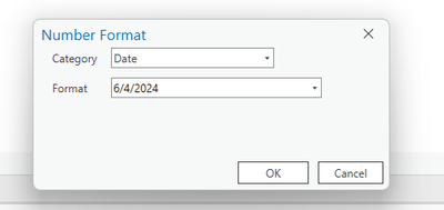

And the below is my date formatting in the field:
BenCapell_NWTF10
Hi @MikhaylaB ,
Based on what I saw in the test. It looks like you need to add '00:00:00' to your SQL query after getting the YYYY-MM-DD so that the query contains YYYY-MM-DD HH:MM:SS format even though it is only showing the year, month and day in the Number Format window. So try adding 00:00:00 following the close of Convert() and before the " on lines 7 an 8 above.
