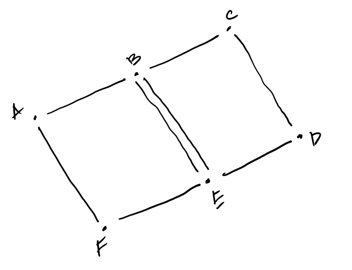

I'd like to identify the geometrically identical features, usually a pair, and then transfer an attribute from one feature to the other within that pair.
To wit, in the below image:
There are two geometrically identical lines between points B / E, though they may possess differing attributes in one specific field. I'd like to keep all existing attributes in each line, but also add the attributes in that specific field from each of the lines to the other into a newly created field.
