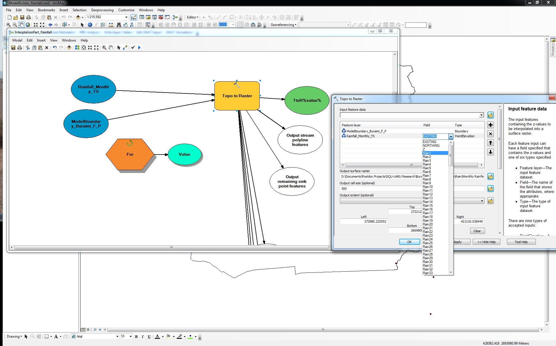

azizallahizady
Deactivated User
Dear Andrew,
