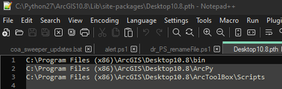

JamesStout101
Using 10.6 have none of these lines.
DominicRobergeIADOT
you still should have C:\Python27\ArcGIS10.6\Lib\site-packages
then open the Desktop10.6.pth with notepad
I am using 10.8 and got this
C:\Python27\ArcGIS10.8\Lib\site-packages\Desktop10.8.pth
