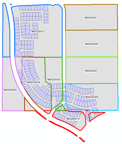

An illustration of the problem is shown below for one of the sets of features in FC_A and FC_B that all share a common Case_Field value.  The polygons with a grey fill and a colored outline are in FC_A and are labeled with the value stored in the Value_Field.  The polygons that are colored light purple are in FC_B and have Null in the Value_Field.  (Note: some of the values in the Value_Field of FC_A are actually associated with many polygons, but they should all be treated as a single dissolved polygon for the purposes of this algorithm.)
Input Polygons for a given Case Value in FC_A and FC_B

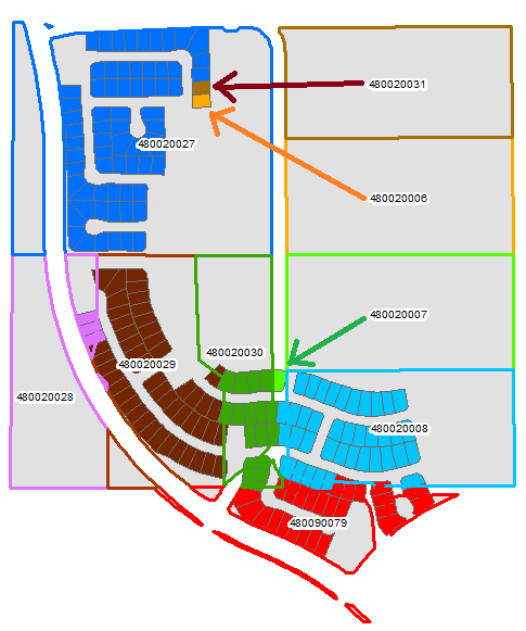

The solution should look something like the output below.  The FC_B fill and the FC_A outline have been assigned the same color for each value in the Value_Field
Output of FC_A and FC_B solution
Notice that values from the polygons in FC_A that do not overlap any of the polygons in FC_B have still been assigned to one of the FC_B polygons.  I did this manually, so I may not have chosen the closest polygon to satisfy condition 4, but I would expect the algorithm to chose the closest polygon.
