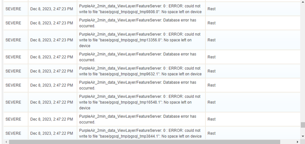

As a follow up to this, it looks like a server space issue... Received the following from one of our GIS admins from the logs:
